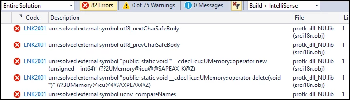

I am trying to figure out what the problem is with my Toolkit. I have a toolkit (DLL) that I compiled using VS2010 and it works fine.
Now I am trying to do some modification to it and compile it for Creo4. In the mean time change computer, so no more VS2010 installed.
I get this message:
Anyone can give me a hint on how to fix this?

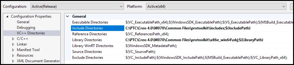

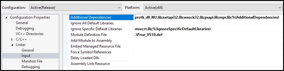

Here's some settings:
The only change from my previous compile, id the Creo path change from Creo 2 to Creo4, and also the "protk_dll_NU.lib" was "protk_dll.lib".
Apr 17, 2019 5:54 PM UTC
According to the user guide Appendix E it looks like you need to add ucore.lib and udata.lib to the library list.
The files are located on the same directory as protk_dll_NU.lib

Apr 17, 2019 6:02 PM UTC
Thanks GabrielZaha, it did solve the issue. Never caught that detail !!
