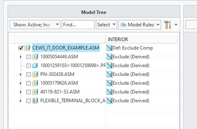

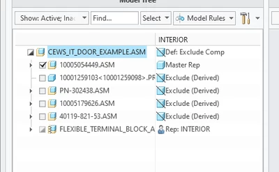

4. Example of INTERIOR SimpRep definition before running application:
After running application with `SetItems(items)`: where items only includes 10001259103<10001259098>.PRT
