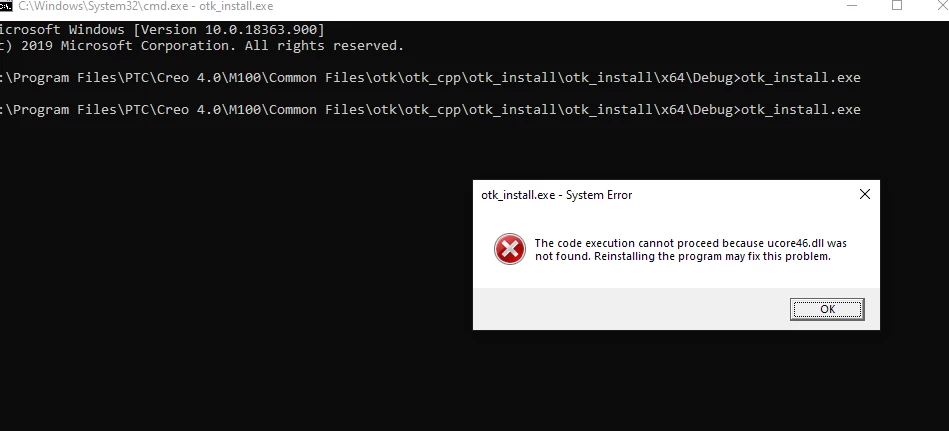

Hi @MartinHanak
1. COMPUTERNAME  and hostname are same
2. Set the Env Path
But when trying to run otk_install.exe through console i am getting this issue, should i need to change the dir of my plugin?
Oct 8, 2020 12:11 PM UTC
@VG_9645254 wrote:
Hi @MartinHanak
2. Set the Env Path
I found ucore46.dll in E:\PTC\Creo4_M130\Creo 4.0\M130\Common Files\x86e_win64\obj directory.
Try adding this path to PATH variable.
