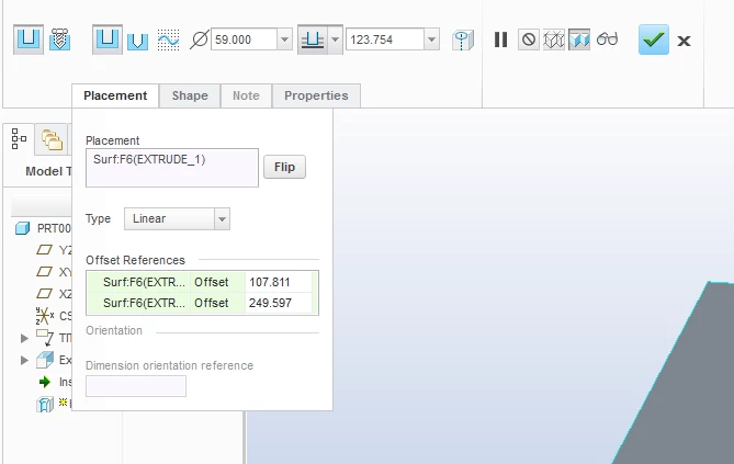

I am designing dialog (GUI) of Creo application. What I need is to have some control on GUI which can hold multiple user selection. Refer attached snap to have idea on what I am looking for:
Refer Offset references into attached snap. I think same can be achieved through table component, but I need to ensure whether another best method is there or not.

I think that is a table and there is no other option to do this.

Any idea what action to be embedded which provide functionality to user for selection of surface?
In other words, Once user click on table cell, it should ask for surface selection. I will do use Proselect() with surface as filter, but I am missing on what to be done for binding this API with user click action on table cell.

I think I got it. It's combination of API ProUITableActivateActionSet() and ProUITableSelectednamesGet().
