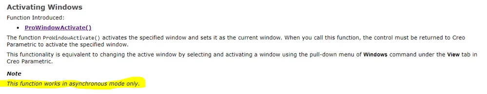

Jun 27, 2022 4:55 PM UTC
This is why:
try to build a simple async app.
HIH.
