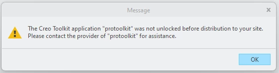

I am not able to unlock protoolkit and getting error message. error attached here.
Is this need separate license or Creo license is enough to unlock?

When I tried to unlock, I am getting this error unlocking this application requires option TOOLKIT-for-3D_Drawings.
it is simple ... your application uses functionality which requires TOOLKIT-for-3D_Drawings (FEATURE 222) -AND- you do not have license code for module 222.
unlock action is usually done be application creator.

Are trying to use a Toolkit app in a Creo session or are you needing to access the Toolkit API to develop a custom application?
If you need to register an application (protk.dat) then see this link. You do not need a toolkit license to register an app created using the Toolkit API.
Registering a Creo Toolkit Application
