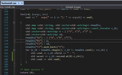

I am using Visual Studio 2015 to create a function to loop through Creo parts and store them in a vector/map.
When I try to include #include & #include into the solution, it throws up many errors.

    Apr 20, 2021 5:21 PM UTC
    use PTC provided VS solution from pt_install_cxx.zip which could be found in protoolkit\x86e_win64\obj directory.
    Compile, link, run.
    if pt_install_cxx app is not working you would have to adjust your system environment CREO_INSTALL settings and probably to modify solution's 'include directories' settings and 'source directories' settings. Make sure that the platform toolset specified in Pro/TK user guide is in use. This is about the extent one would need to tweak out of the box pt_install_cxx VS project.
    Add your std::map and std::vector statements to TestInstall.cxx file. Compile, link, run. Should work fine.

    Apr 21, 2021 8:56 AM UTC
    How do you use vector, map (code), and what mistake is this?
    For example: I guess that before Update 2 was not fully supported Initializer list constructors. What is the VS2015 version?
    (Definitely use the current VS 2015 Update 3.)
