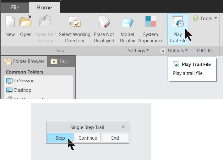

I have a question about mapkeys. Is there any possibility to see what exactly does a mapkey do?
I work with mapkeys, which have been created by either CAD engineers or former collegues and I would like to understand exact procedure of the mapkeys (in general).
The simplier ones can be understood from the config file but not the more complicated ones.
I hope I made the question understandable, thanks for any answer.

Hi Vojtaa,
You could use, for a moment, these 2 config options in your config.pro:
set_trail_single_step yes
visible_mapkeys yes
Open Creo, then run the mapkey you want to explore. Close Creo, look for your last Trail file and  copy it to the Desktop or where you want, open Creo, execute your Desktop Trail file (trail.txt), and you will see step by step, with pauses,  what that mapkey did.

What are you trying to do with the mapkeys?
The best way to learn what is in one is to record one and then look at the resulting file.
I do know they are not easy to edit, except in certain areas of the structure.
They are like a snapshot of the trail file. Recording what you do for a short period of time.
Overall, I am not a fan of mapkeys as the user does not learn the system if they do too much with the mapkeys.
Where I do use mapkeys is for very repetitive things that the user must do. Adding corporate parameters to a file is one, recalculating the weight when mass properties change, etc.

Hi Martin, its not that I don't know what the specific mapkey does. The problem is that I don't know how does it do.
An example - the is a mapkey "dtl" which loads the company dimension style to the drawing with different one. I know what does it do, but I would like to learn the way how to do it without a mapkey. Therefore it would be helpful to see this directly from the mapkey.
It's just an example, no need to explain this specific "dtl" case.

Hi Vojtaa,
visible_mapkeys yes
