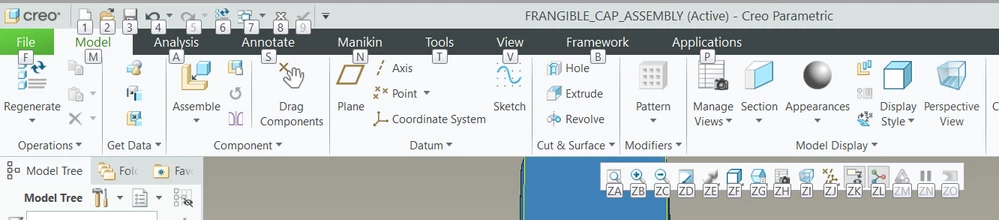

Yes, you can use mapkeys to execute feature creation (i.e. extrude). You can also record the shortcuts within a mapkey.
If you have not seen the built in shortcuts, here is a list.
Article - CS311988 - List of default shortcuts in Creo Parametric (ptc.com)
The ribbon is mapped extensively to keystrokes already. If you press the ALT key it will display the mnemonics for ribbon commands that are available by default. You can use these shortcuts when recording mapkeys. See the labels below (assembly mode).
For example, in part mode: Extrude using keyboard shortcuts is invoked using ALT->m->x  .

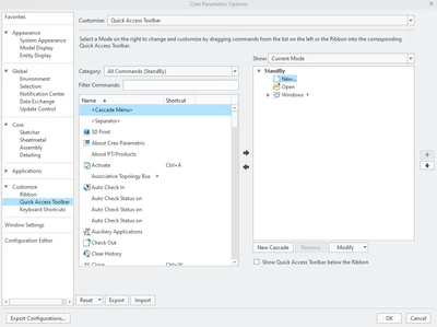

May 12, 2023 3:59 PM UTC
Click on "File", then "Options" and this menu pops up.
Click on "Quick Access Toolbar" and as you scroll, you can see any Shortcut that are put there by PTC.
