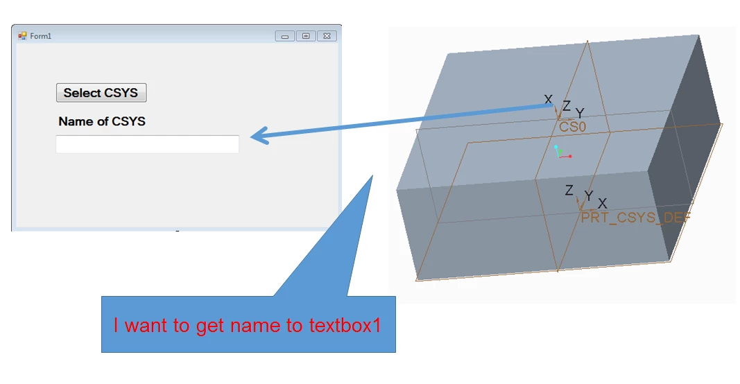

Please help me example VB API in Creo
Create a button1 select CSYS in Creo then get name show in textbox1 in VB.
I want to create button in VB so select object in Creo, I had read ptc document but difficult for me to find example.

Dear Sir
Thanks your reply, I had follow your code but error.
I'm using Visual Basic 2016 Windows form Application not C# (I dont know)
I want to get name CSYS to textbox1
Thanks advance your help

That's simple, you have the model handel, and the feature ID, now you can get the feature name with this two references. In Tcl, working on the current model:
# Get the Feature Name
set FeatName [ps_feat name $FeatID]
