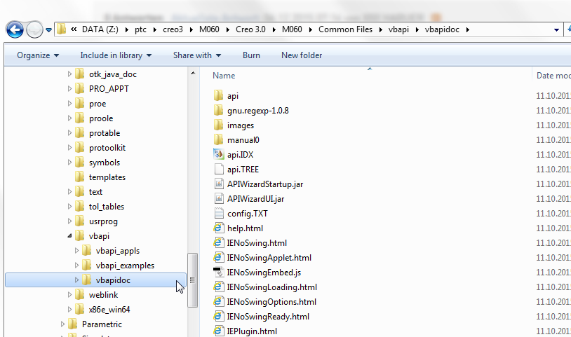

The setup procedure for Visual Studio is described in detail in the VB.API browser coming with your Creo Parametric installation.
The docs (API browser) are located in <creo_inst_dir>/Creo 3.0\M060\Common Files\vbapi\vbapidoc

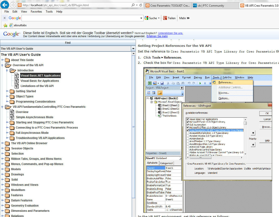

In the User's Guide there is an introduction on how to do the setup and configuration of Visual Studio:
