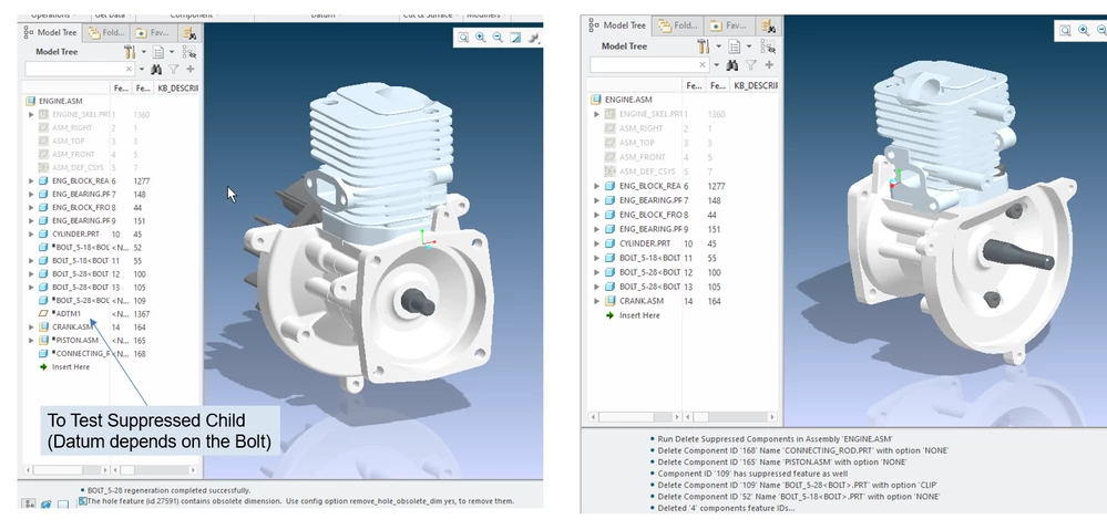

I used the engine.asm from PTC as an example, but added a reference datum plane to one bolt, here one image before and after including the Message Log.

Copy/Paste of the Message Log:
Run Delete Suppressed Components in Assembly 'ENGINE.ASM'
Delete Component ID '168' Name 'CONNECTING_ROD.PRT' with option 'NONE'
Delete Component ID '165' Name 'PISTON.ASM' with option 'NONE'
Component ID '109' has suppressed feature as well
Delete Component ID '109' Name 'BOLT_5-28<BOLT>.PRT' with option 'CLIP'
Delete Component ID '52' Name 'BOLT_5-18<BOLT>.PRT' with option 'NONE'
Deleted '4' components feature IDs...
