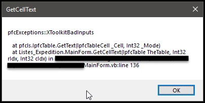

I get into a problem with the VB API and I cannot figure out, using this code:
	Private Function GetCellText(TheTable As IpfcTable, rIdx As Integer, cIdx As Integer) As String
		Try
			Debug.Print("Number of lines in table: " & TheTable.GetRowCount)
			Debug.Print("Number of columns in table: " & TheTable.GetColumnCount)
			Dim MyCell As IpfcTableCell = (New CCpfcTableCell).Create(rIdx, cIdx)
			Dim MyText As Cstringseq = TheTable.GetText(MyCell, 0)
			Return MyText(0).ToString
		Catch ex As Exception
			MsgBox(ex.Message & vbNewLine & vbNewLine & ex.StackTrace,, GetCurrentMethod().Name)
			Return Nothing
		End Try
	End Function
I get an exception from xToolkit at the line "Dim MyText As Cstringseq = TheTable.GetText(MyCell, 0)" but I can't find what I am doing wrong.
Any idea?
Best answer by AlexCote
The code I posted earlier works fine .... as long as you use the right version of Visual Studio !!!
Darn, I was using VS2017 ... now in VS2015 it works fine. I forgot about those version compatibility !!!
AlexCote1-VisitorAuthorAnswer
December 19, 2019
