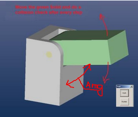

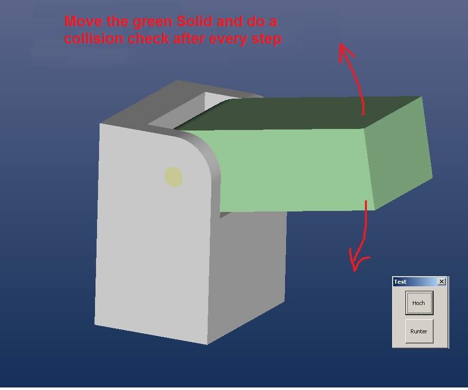

I'm trying to move a solid with vba and after every single moving step i want to do a collision check with vba.
For better understanding, i made a picture to show the situation.
Is this possible? Can anyone help me or give me some examples?
Thx

The easy way to move solid part, like in you picture:
1) create assembly with Angel Offset constraint, between two part.
2) Using Relations, map this constraint/dimension to the parameter (d0 = pAngel)
3) Now in VB API you can change the value of the pAngel parameter. In this case the part will be moved after regeneration.
About a collision check: jlinkug.pdf
Page 257: Geometry Evaluation -> Interference
Example Code
The sample code in the file UsrInterference.java located at
<creo_jlink_loadpoint>/jlink_appls/jlinkexamples finds the
interference in an assembly, highlights the interfering surfaces, and highlights
calculates the interference volume.
Good luck!
