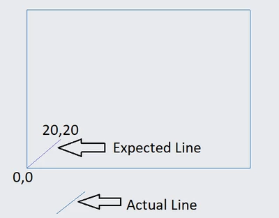

When drawing a simple line using the sample VB API code, a line appears in the drawing but the wrong place consistently.
Using the code below, a line is expected from 0,0 to 20,0

When I check the coordinates again, they show correct values.
MessageBox.Show("Start = " & start.Item(0).ToString & " x " & start.Item(1).ToString & vbCrLf &
"End = " & finish.Item(0).ToString & " x " & finish.Item(1).ToString
Am I missing any transformation?

From the documentation:
The VB API methods and properties that manipulate drawings generally use screen coordinates.
You need to transform drawing coordinates to screen coordinates before to put it into a method.
