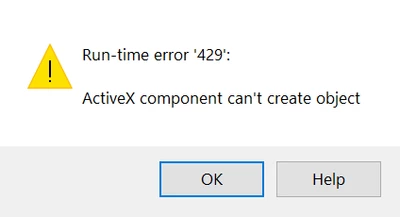

i have all set up VB api in my pc along with i have marked vb reference in creo as well but when i try to run below code i am getting error;
'globale Variablen:
Dim asyncConnection As IpfcAsyncConnection
Dim cAC As CCpfcAsyncConnection
Dim hSession As IpfcBaseSession
Dim hCurMdl As IpfcModel
Function Connect2ProE() As Boolean
Set cAC = New CCpfcAsyncConnection
Set asyncConnection = cAC.Connect(Null, Null, Null, Null)
Set hSession = asyncConnection.session
Connect2ProE = True
End Function
Private Sub but_connect_proe_Click()
bProeConnect = Connect2ProE()
End Sub
your help really be appreciated. Thanks

Jul 15, 2021 6:35 AM UTC
Hi @Ragnarok8979
You need assistance with your VB code throwing an error. Let's clarify a little my scope: I cover several Creo Toolkit offerings and VB is not part of that. i'm sorry.
Now given the screencapture, the error code does not look like a Creo error.
Do you have a mean to test your connexion to the Creo session? other than with this code?

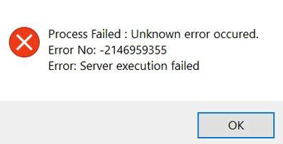

Jul 15, 2021 6:52 AM UTC
Hey Remy,
thanks alot to jumping in.
what i feel is that creo is not able to connect with vb api..below is error i see

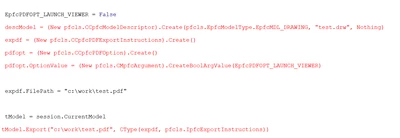

Hi

Jul 15, 2021 2:58 AM UTC
any idea why this code showing red highlighted(not working)
Jul 15, 2021 4:59 PM UTC
While similar, VB is not VBA. Excel uses VBA. When translating VB examples into VBA, you will need to translate the code to work in VBA. Examples:
  • When defining object variables you need to add Set cAC = New CCpfcAsyncConnection. This isn't required when using simple variables like strings, integers, boolean, etc.
  • When trying to execute tModel.Export() you need to add Call tModel.Export(). However, it seems to be inconsistent when adding this is required. For example, when using CreoWindow.Activate it is not required.
  • Some VB commands aren't supported in VBA.
    • Try/Catch is not available in VBA. You will have to use the VBA On Error GoTo
    •  Ctype is not available in VBA. In VBA, Dim two separate variables and Set one object type equal to a different object type to convert. Example:
      • Dim model As IpfcModel
        Dim solidMdl As IpfcSolid
        Set model = session.CurrentModel
        Set solidMdl = model

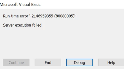

Jul 15, 2021 7:36 PM UTC
At the end it is Toolkit, did you add PRO_COMM_MSG_EXE to the System variables and you run vb_api_register.bat?
No connection if path to pro_comm_msg is not specified.
Jul 16, 2021 3:06 AM UTC
yes bro that is done. i can also see vb reference in excel. but dont know why i am not able to connect. could you please help me further.
just to let you know nmsd.exe not running. how can i make that run. i try double clicking on that but didn't worked

Jul 16, 2021 6:45 AM UTC
@Ragnarok8979  could you please try the below ?
1) Start Creo Parametric with elevated previlages .Use Run as Administrator or start parameteric.exe from a command prompt window that is launched as 'Run as Admin'
2) Start MS Excel application also as "Run as Administrator"
3) Now try executing your VBA Excel script and see if the connection succeeds.
4) Also, try changing the line Set asyncConnection = cAC.Connect(Null, Null, Null, 50) 'this mean that try attempting to connect to Creo for 50 seconds.
