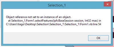

I'm trying to make a selection, using the example in instalation folder. I'm connected with the running session in CREO, but I'm unable to make the selection.
There is an messagebox appearing the follwing message.
Any help?

Dec 11, 2019 7:33 AM UTC
show a piece of your code from Form1.vb near line 54
T_F16-PearlAuthor
Dec 11, 2019 8:48 AM UTC
I've found the problem.
The code at the moment like this:
selopt = (New CCpfcSelectionOptions).Create("part")
selopt.MaxNumSels = 1
sel = session.Select(selopt, Nothing)
pobj = sel.Item(0).SelModel
At the moment is working. Now I'me strugling with parameters. I'm trying to fill a string parameter in CREO, by VB. And I can't do it... I've the way to do for a real number parameter, but not that easy to a string parameter.
