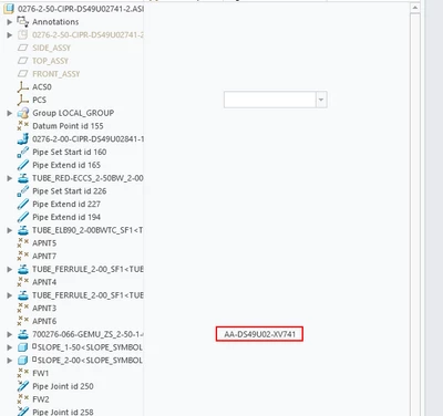

See the picture here. We often have a feature parameter in an assembly. That can avoid assigning different parameter for the same components in different assemblies.
Very often we need to change the value of this parameter. I am trying to write a vb.net code to automate the process but cannot find the proper interface, method or function to perform this task.
Can anyone share a hint? Thanks

Configure the model item, the owner is the model, the type is a FEATURE, the ID is the feature id, that’s it. The rest of the calls are the same. I guess there a couple of examples for VB. BTW, you still have to configure the tree, in C I don’t know any API to configure the tree display columns.

Thanks 17-Peridot,
I follow your comments and successfully extract the data.
In case someone else has the same question as mine, I attached my code here for the reference.
Thanks again for 17-Peridot 's help.
