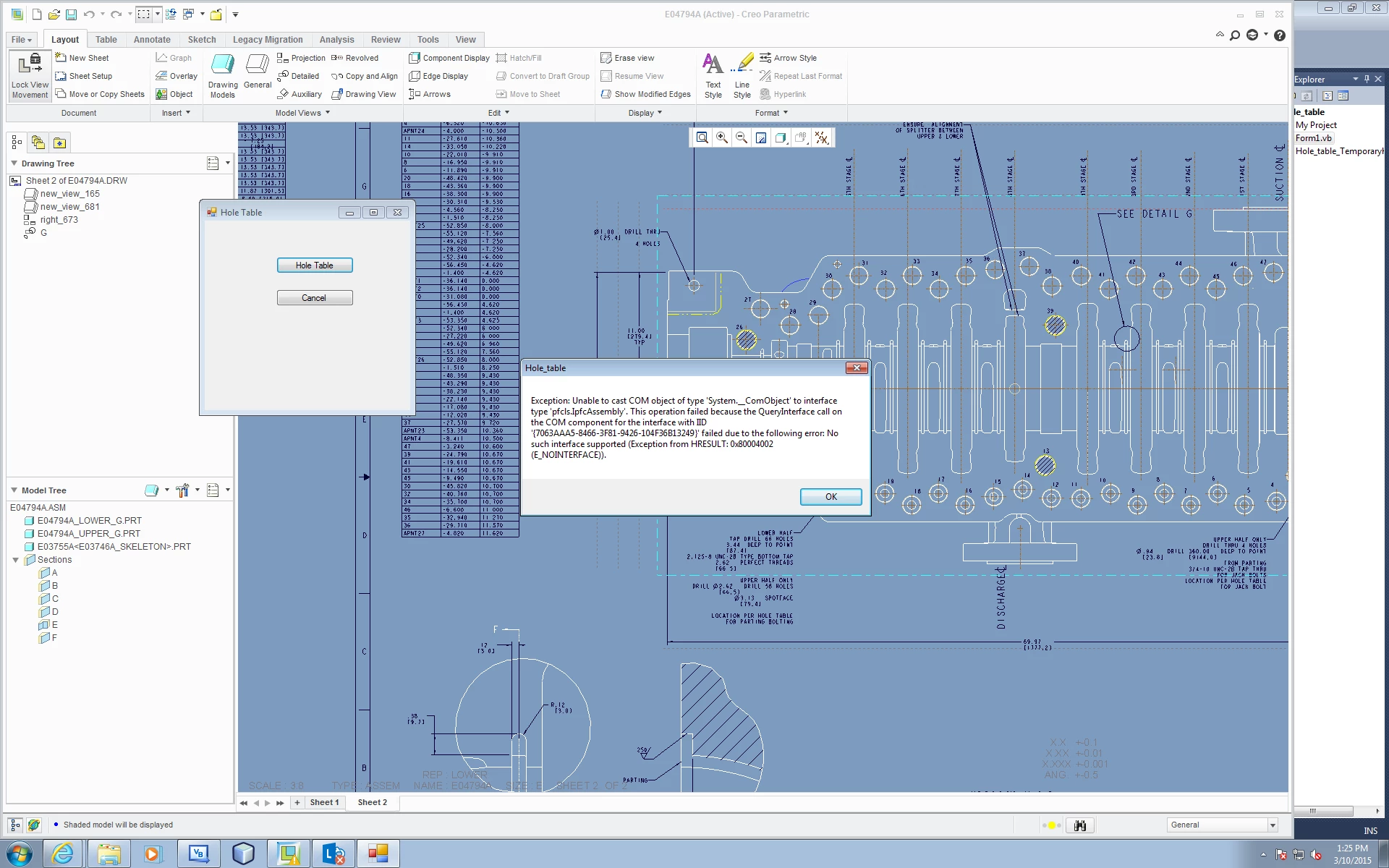

VB API Tool Kit for Assembly Drawing from Part Drawing
What needs to be modified in the existing VB Program syntax to refer
assembly drawing since original API Kit was developed to refer part model
drawing.
Note: API Kit is working well for part model drawings. Refer below for the
coding which created to read part model in the drawing.

Here is the sample code. I am trying to chenge the assembly drawing.
I am getting some exception. I have attached the exception.
