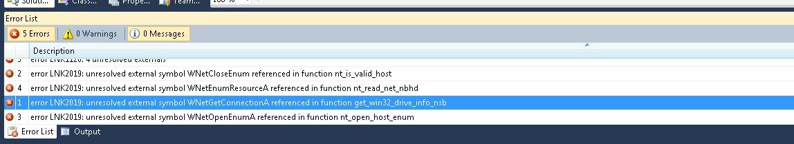

I am getting attached error:Any idea?
Feb 27, 2017 12:42 PM UTC
Think you forget the mpr.lib
We use the following libs to compile:
ws2_32.lib;wsock32.lib;mpr.lib;netapi32.lib;psapi.lib;protk_dll.lib;otk_cpp.lib;Msimg32.lib;wldap32.lib;%(AdditionalDependencies)
