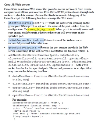

Hi there,
I'm looking about any informations about creo_js_app.conf file.
This file is needed by new CreoJS webserver to define some variables like port number or jscript files directory.
But don't find any information on the documentation given with Creo Parametric 7.0.2.0
Where this file must be located ?
Which kinds of variable could be set within this file ?
With which syntax ?
Thank's for your help,
Hugues

Nov 19, 2020 10:27 AM UTC
From creojsug.pdf
Manually configure Creo to specify the desired Web server port by editing the
creo_js_app.conf file located in your working directory.
About content, I think, need to try some thing like this:
port 8888
and
other variables what you need.

Nov 19, 2020 11:07 AM UTC
Hi Pearl,
I just need to make some tests with CreoJS server.
Today, I use php server to access localy on data like csv or xml files stored in local file system and use the content in Weblink scripts.
So, when I read the news about CreoJS on Creo 7, I try some 'things' to test CreoJS Server and debug console with Chrome.
Thank's for your advices.
I will test them asap.
