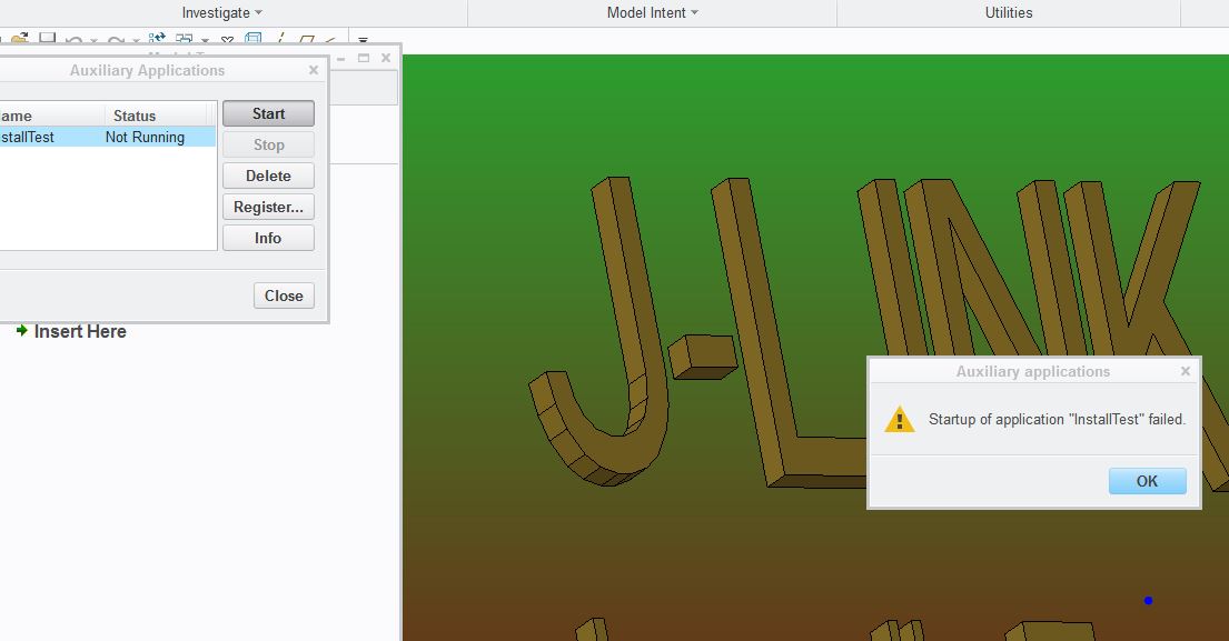

I have followed jlinkug.pdf, setting up j-link, and the sample applications, installing j-link, sample applications, and install test.
I have tried over and over again but still no luck.
here is my protk.dat
name startInstallTest
startup java
java_app_class StartInstallTest.java
java_app_start start
java_app_stop stop
java_app_classpath C:\jlink\jlink_appls\install_test
allow_stop true
delay_start false
text_dir C:\jlink\jlink_appls\install_test\text
end
here is one step im not quite grasping.
1. Set the path and CLASSPATH variables to include the Java
Development Kit as described in Java Options and Debugging on page
409.
2. Set the CLASSPATH to include the J-Link synchronous archive and the
current directory.
On Windows set the CLASSPATH as:
set CLASSPATH=<creo_loadpoint>\<datecode>\Common Files
\text\java\pfc.jar;%CLASSPATH%
3. Compile the java files in the directory using the command javac *.java.
March 17, 2015
PTC does not enable you to use any Java version. See attached file.
Martin Hanak
