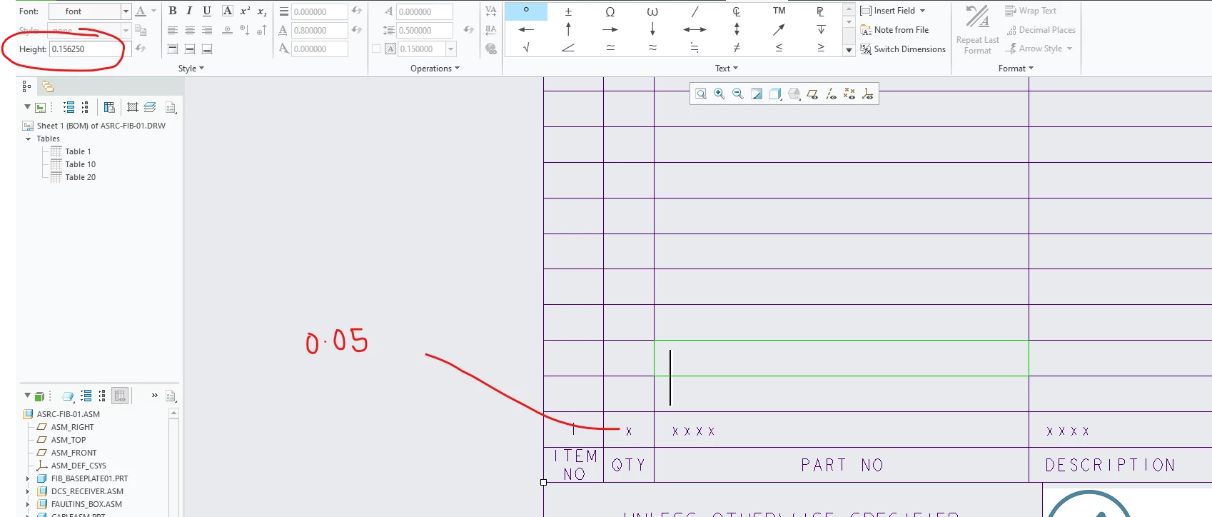

What is Table Text default size option in config.pro
What option on config.pro  OR dwg.dtl controls default table text?
See attachment image for proper understanding of issue/question.
Thank you! Creo is King!!!
Feb 23, 2026 7:21 PM UTC
Set the text size you want before you create the table. This will become the default text size for that table.
See this older community posting: Solved: Drawing Tables - New Table Row Text Size and Align... - PTC Community

Here is my conclusion:
Creo does not have config setting for text setup in tables.
Best Solution I prefer: Create table commonly used and copy paste it to new .dwg
Place the table in common general.dwg containing symbols, notes, tables.... etc.
