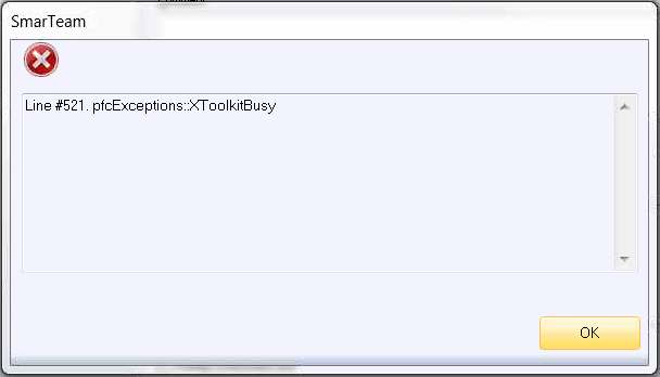

When connecting to Creo through a VB.NET application, why am I getting an "xToolkit Busy" error?
Through the SmarTeam integration, my referenced VB.NET COM object attempts to connect to the existing Creo session but fails with an error depicting "xToolkit Busy":
My code is as follows, and the error occurs at the first Connect() method:
Dim asynconn As New pfcls.CCpfcAsyncConnection
Dim conn As pfcls.IpfcAsyncConnection
Dim CreoSession As pfcls.IpfcBaseSession
conn = asynconn.Connect("", "", ".", 5)
conn = asynconn.GetActiveConnection()
CreoSession = conn.Session
'... Do stuff here
conn.Disconnect(2)
I have ensured the following:
  1. JRE component is installed for Creo
  2. System environment variable is set to PRO_COMM_MSG with path to the .exe file (includes whitespace)
  3. J8U40 (64 bit) is installed
I'm not sure what else to look for or how to troubleshoot this.  Any advice is appreciated.

Hello Sarah Nguyen‌
Remove this statement
Your coding trying to execute this statement before connecting to creo. That's why Toolkit is Busy.
and use
If conn IsNot Nothing Then
End If

I tried your suggestion but am still receiving the same error.  Any other ideas?
Mar 16, 2017 5:06 PM UTC
Let me know for which statement, you getting the error
And try this
conn = asynconn.Connect(Nothing, Nothing , Nothing, 10)
