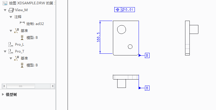

I create a gtol with ProToolkit, the steps are as follows,
ProGtoldataAlloc(drawing,&gtd);
ProGtoldataTypeSet(gtd,type,&gtds);
ProGtoldataModelSet(gtd,solid,&gtds);
ProGtoldataReferenceSet(gtd,rtype,reference,&gtds);
ProGtoldataPlacementSet(gtd,ptype,NULL,NULL,location,NULL,&gtds);
ProGtoldataPlaneSet(gtd,&plane);
ProGtoldataGtoldatumrefSet(gtd,NULL,NULL,NULL,&gtds);
ProGtoldataDiameterSet(gtd,diameter,&gtds);
ProGtoldataValueSet(gtd,b_v,d_v,name,&gtds);
ProGtoldataMatCondSet(gtd,matcond,&gtds);
ProGtolCreate(gtd,&gtol);
ProGtoldataFree(&gtd);
ProDrawingtreeRefresh(drawing,PRO_VALUE_UNUSED);
the result is NO error, and the gtol is displayed on the drawing,
However, the gtol is not displayed in the drawing tree.
if i set the placement of the gtol (created by the protoolkit) as freenote once more in the drawing,(without any other change)
the gtol is visible in the drawing tree then.
Do i missed some statements, or set something wrong?
