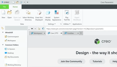

we are migrating from Creo9 to Creo10 but I have an issue with the embedded browser only when I open Windchill.
When opening Windchill both Workspace and Commonspace, the browser resolution is very very small and vey difficult to read.
I've changed the DPI from the parametric.exe configuration but I either have this very small browser line or very blurred icons of the Creo software.
For information I have no issue with the Creo9 we have used so far, same config, same DPI configuration, different outcome.
Do you have any other suggestion about how to solve this issue?
Thank you!

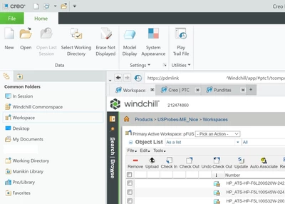

May 7, 2025
Did you try to press Control on the Keyboard and at the same time with the middle mouse button to change the font size for the Windchill HTML display? Change the DPI will probably not help.
gstall10-MarbleAuthor

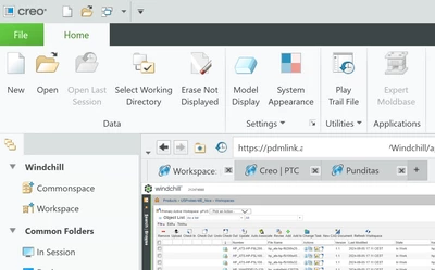

May 9, 2025
It seems to work (didn't try the classic solution that always work, thank you! 😀) but when I reboot Creo I still have the small view on the Windchill page.
I think it is linked with DPI because when I change them to be forced by system or application I can solve the issue on Windchill, but I have very blurred icon.
I think that, waiting for better solution the only way to go is to scroll in on Windchill page every time I open the application.
