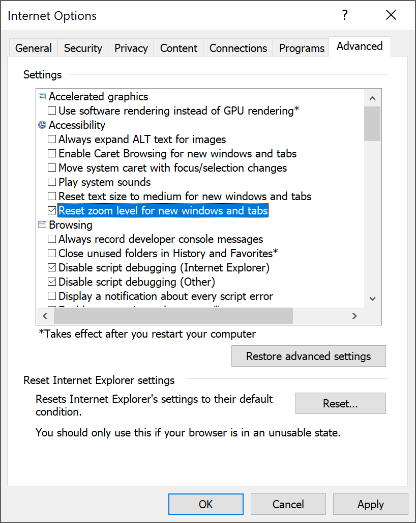

    May 11, 2017 4:51 AM UTC
    CTRL + 0 sets your zoom to be 100%.
    I have the same problem in Creo 3... but from my experience, this seems to be fixed in Creo 4.
    In terms of "normal IE" operation, if you load up your Internet Options, and go to the 'Advanced' tab, there is a checkbutton to "Reset Zoom on new windows and Tabs"
    That fixes my NORMAL IE tabs... but doesn't seem to fix the embedded browser sadly. I'll investigate more tomorrow though
    James Sullivan
    CadActive Technologies
