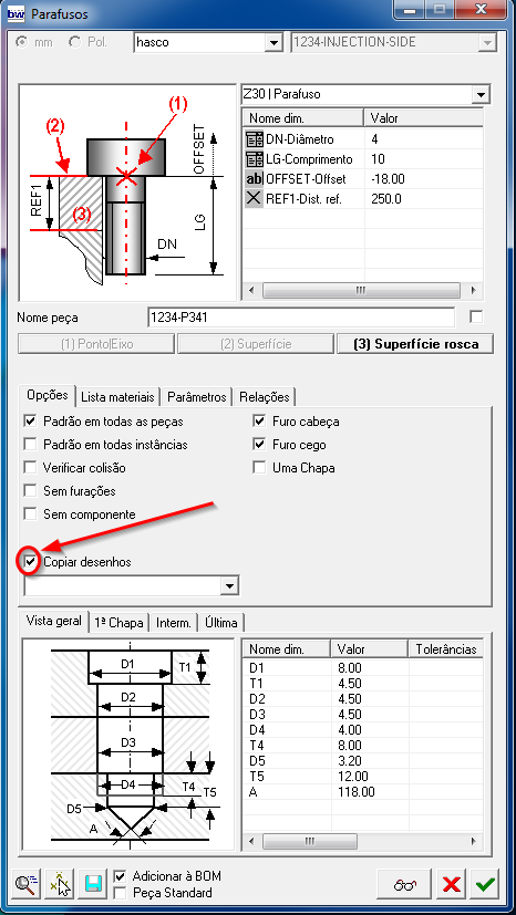

I´m using EMX70_M030 right now. When I add a component, the option "Add Drawing" is on by default. Each time I add a component I have to turn it off. Is there a option to turn it off by default?

Hi Jose,
To disable that option you will have to remove the corresponding drawing file from the component folder:
In this case it would be %EMX_USER_CONFIG_PATH%\components\mm\screw\screw_1.drw.
Hope it helps!

Hi Florin,
I was expecting for a option in the emx_options.cfg, but that can work too.
Thanks for your help.
