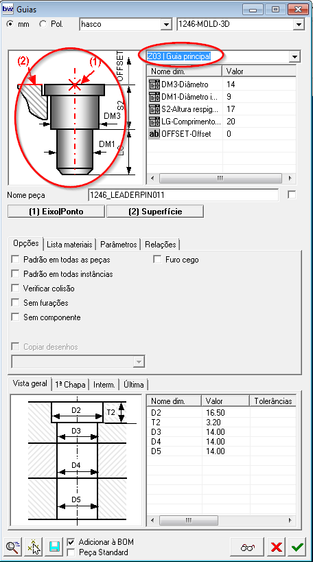

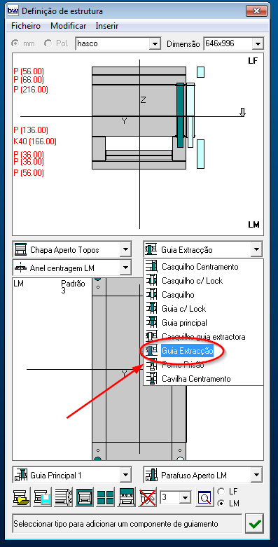

We usually use the Z03 reference (Hasco) as ejector guide, but in the "Assembly Definition"->"Ejector Guide" this type doesn´t appear. Is it possible to add it?

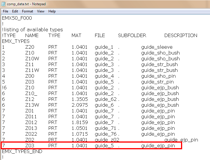

Add the line below to comp_data.txt in folder <EMX>\components\<unit>\guide\hasco. It will be available when assembling ejector guide.

Sorry, not working properly.
The Z03 guide now appears on the assembly definition but when I press ok, It says an error message:
"Cannot assemble the component"
The cut-outs are opened on the plates the guides do not appear.
February 20, 2013
It should work. I'm using EMX 8.0 F000.
February 21, 2013
You´re right, the guide_5 part file was corrupted, I replaced it with the original and now it´s working.
