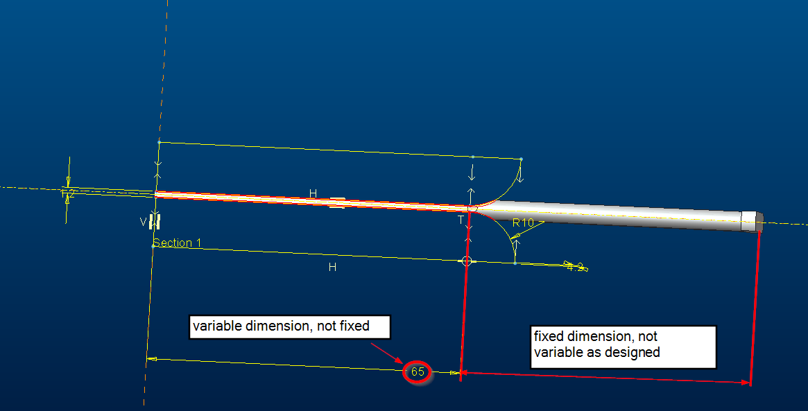

Meusburguer ejectors aren´t designed correctly. The dimension showed in the picture is fixed and should be variable(after being cut by part). This leads to errors in mold designs.
I have corrected some of the files in version 7, but now that I´ve installed version 8.0 I have to do it again.
Please correct this problem for future versions.
This happens in stepped and blade ejectors.

Hi Jose,
Thanks for the hint, I will check this issue myself.
Anyway, you can use in EMX 8.0 the same data (parts and configuration files) you have corrected in EMX 7.0. The 2 versions are fully compatible regarding the data format. So you don't have to correct it again in EMX 8.0.

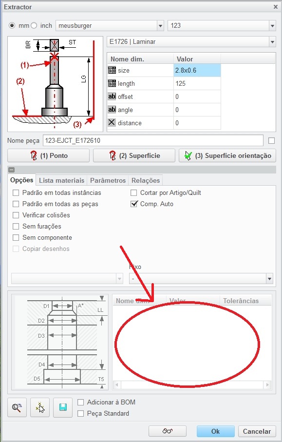

In Meusburger ejectors we are having two more problems:
1 - Accuracy problems. Other ejectors come with absolute accuracy 0.001, Meusburguer ejectors come with Relative 0.00012.
2 - New ejectors don´t seem to work correctly - E1702, E1712, E1715, E1726, E1727, E1728, E1745, E1786, E1790
