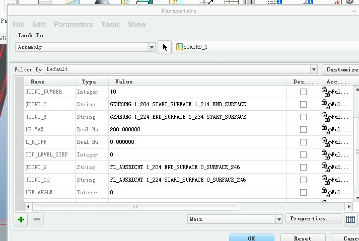

now such as in the folder efx\parts\equipment\steel_construction_mm\stairs\stairs_1.asm,
parameters in this component,such as joint_5,joint_6,joint_9,joint_10,
and now these 4 parameter value represents the mean,I do not understand ,

    For every part that can be assembled with AFX, there should be a *.TAB file in het library folder.
    This TAB file has the same name as the part/assembly or UDF that is created/assembled.
    This TAB file is written in a kind of BASIC language, and is pretty good readable.
    The parameters you mention are probaly used in this TAB file to look for the correct references in the part where the joint is assembled in.
    I don't know if there is a general help file to explain all commands used in these TAB files, or that explain the link between both.

    there is a command
    CREATE_JOINT in AFX scripting langugae to create joint. An example can be seen in
    AFX file <afx_instal_dir>/parts/steel_construction_mm/no_standard/endplate.tab
