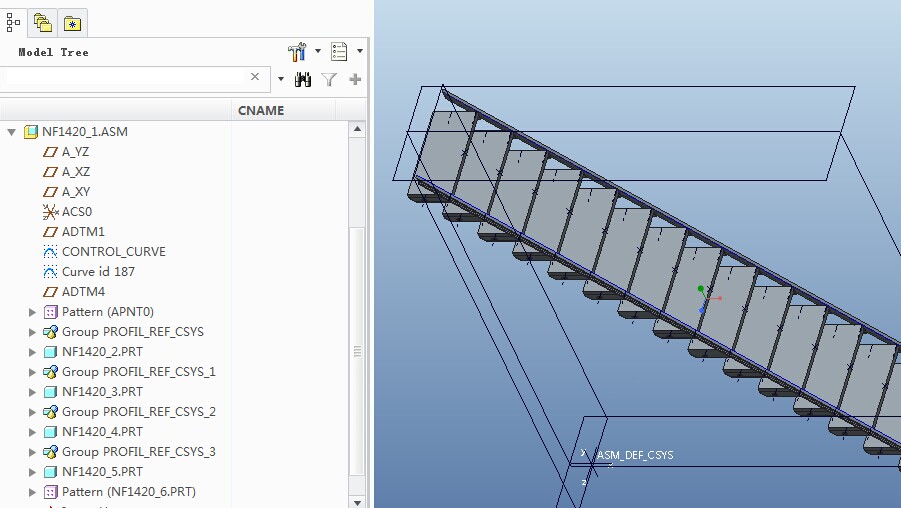

what can I do to creating model name one by one at the project subassemblies in afx/equipments
  • May 25, 2014
  • 12 replies
  • 5181 views
AFX should be establish the project name and support the named parts/assemblies one by one
but there is a large problem in efx/equipments.

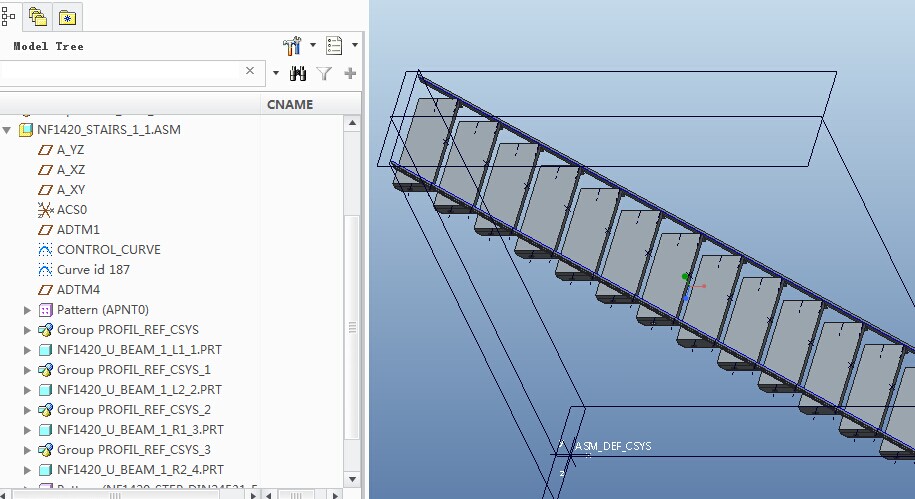

project_name=1420 ,
the named stair assemlby: NF1420_STAIR_1_1
the named stair parts: NF1420_ U_BEAM_1_L1_1 ,and so on;
So I can create the element_name.txt in \efx\parts\equipment\steel_construction_mm\stairs ,
The content :PROJECT_SHORT#_#ELEMENT_NUMBER
now
project_name=1420 ,
the named stair assemlby: NF1420_1;
the named stair parts: NF1420_ 2;
NF1420_3 ,and so on;
These named parts/assemblies are not my named code;
so I need a named code ,for example:
project_name=1420 ,
the named stair parts: NF1420_ 1-1;
NF1420_1-2 ,and so on;
I need help from buw and tell me the named code .
THANKS !

    seems the only thing you are missing is to replace the "_" by a "-". If this is correct just replace
    #_# by #-# in file element_name.txt
    Stefan

    hello,stefan
    You still haven't answered my question.
    These are correct by used "_"or"-" in file element_name.txt
    there are no problem,look at the picture above.
    how to create the named code one by one in afx/equipments.file ?

    you can put
    SUBASSEMBLY_NAME#-#ELEMENT_NUMBER
    into element_name.txt and set option , but then the files will be named like
    NF1420-1-2
    I do not know in what cases you make "-" and in what cases you make "_" between the numbers
