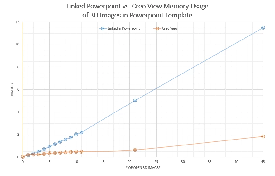

The use of the Creo View API to create an interactive 3D Product View instance within Powerpoint has caused problems with management of computer resources. Each new figure that is loaded on a new slide in PPT adds another process to the CPU, On average this amounts to 250 MB of memory utilized per slide containing an instance of Product View, which quickly becomes unsustainable (as shown in the attached image). We are looking to find a way to decrease the amount of memory used, particularly by not requiring a new instance of Product View for each step in the Work Instruction. A method that we have looked into is the ability to embed the .pvz model in the powerpoint file (similar to how multiple figures can be opened in a single instance of Creo View), but were informed that this is not a current capability of the Creo View Office Toolkit.
Work has been done to only allow a certain number of Product View instances, and terminating all other Product View processes in a first in first out style queue. However, this prevents those slides on which the product view window was terminated from being reopened.
