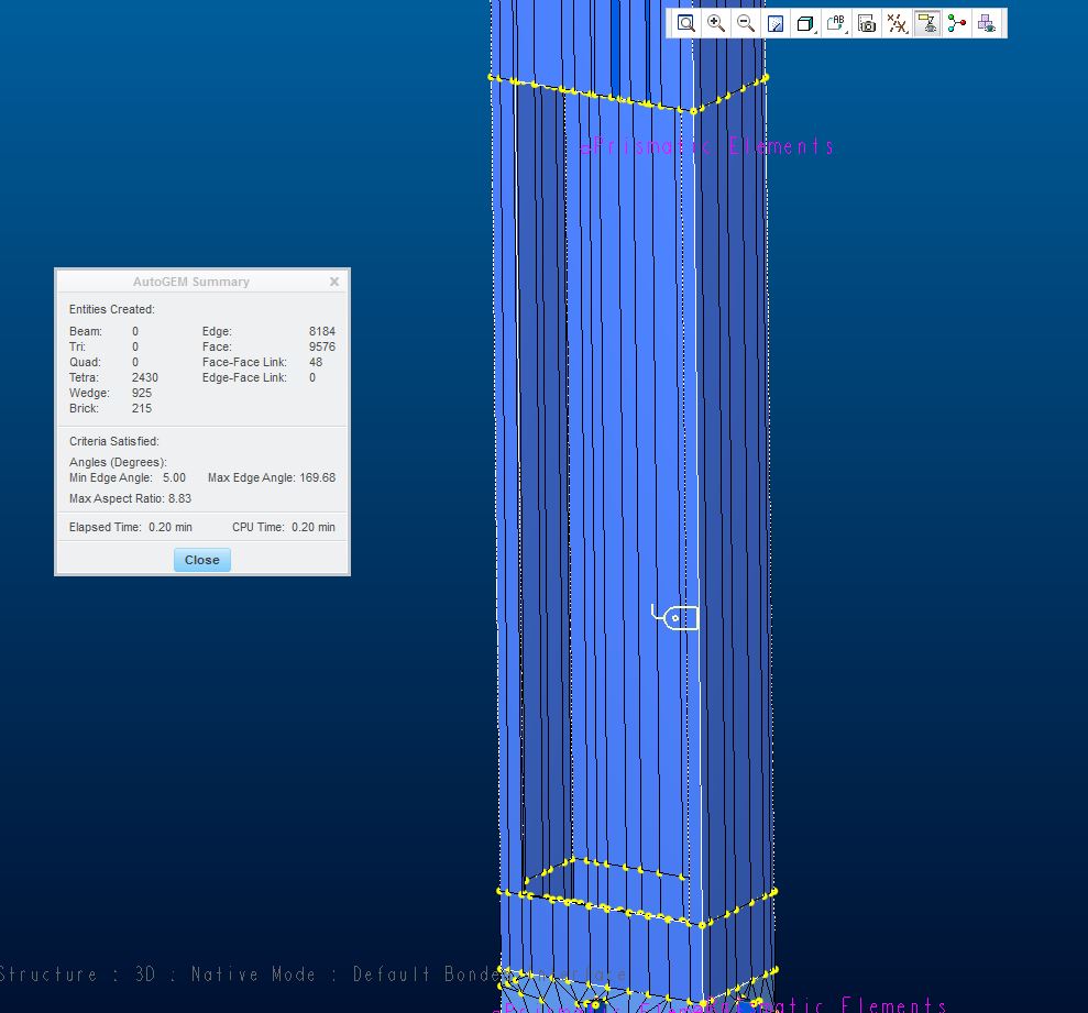

Hi all,
although in AutoGem settings it is setted a max aspect ratio of the elements of 10, where there are bricks and wedges this rule is not observed.
You can see the image below. (Creo 2)
The question is simple: why?
Regards
gfraulini17-PeridotAuthor
September 17, 2014
The ratio of the elements is more than 10.
There are elements too long in height in respect the base
