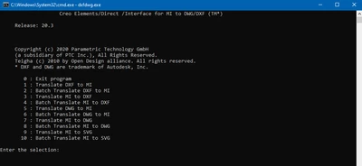

The batch mode is the selection No 8 (for MI to DWG):
To convert files from different folders, give the full path name of the files, example:
c:\temp\Folder1\File1.mi
"c:\temp\Folder 2\File 2.mi"
If spaces are present, add quotes.
See the translator manual at:
https://support.ptc.com/help/creo/ced_drafting/r20.6.0.0/en/ced_drafting/baggage/dxf.pdf

In terms of quality, 2) and 3) are better than 1) because 1) will translate first from MI to Creo, then from Creo to DWG (two translations).
Still in terms of quality, 2) and 3) are exactly the same, since Modeling, Modeling Express and Drafting use the same tool dxfdwg.exe.
In terms of ease of use, 2) is better tahn 3), since there is a batch mode with dxfdwg.exe; All the files can be translate in one shot.
There is not better translator from MI to DWG than dxfdwg.exe.

So dxfdwg.exe has a function to covert a file's batch? I didn't know that.
That function can convert file from different folders (with a common parent folder) or all the file needs to be in the same folder? If it can do that it will be very useful.
