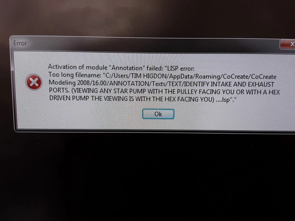

I'm having a problem starting Annotation. The error involves TEXT that i have "DEFINED AS A TEMPLATE".
The error states that the defined text is too long. I think if I can delete the this text the problem will be resolved.
I have tried to follow the file path in the error but have had zero success.
Can someone tell me where these text/templates are stored !?

So when you follow the path in the error you don't see the .lsp file with a name that starts with "IDENTIFY INTAKE..."?
November 4, 2019
The error message says "too Long filename".
I suspect that some LISP code has concatenaded wrong/corrupt data to build the filename.
I do not assume that the (strange) file should really exist.
Finding out the root cause requires LISP troubeshooting skills.

Yes, I know what the error says, and It is a real error it is not concocted.
There is a text I created "IDENTIFY INTAKE AND EXHAUST PORTS, (VIEWING........." then saved as a TEMPLATE is partially in the error message  Apparently it is too long for the file limits, which is the root cause..
I need to know where these Template - Texts are saved.
