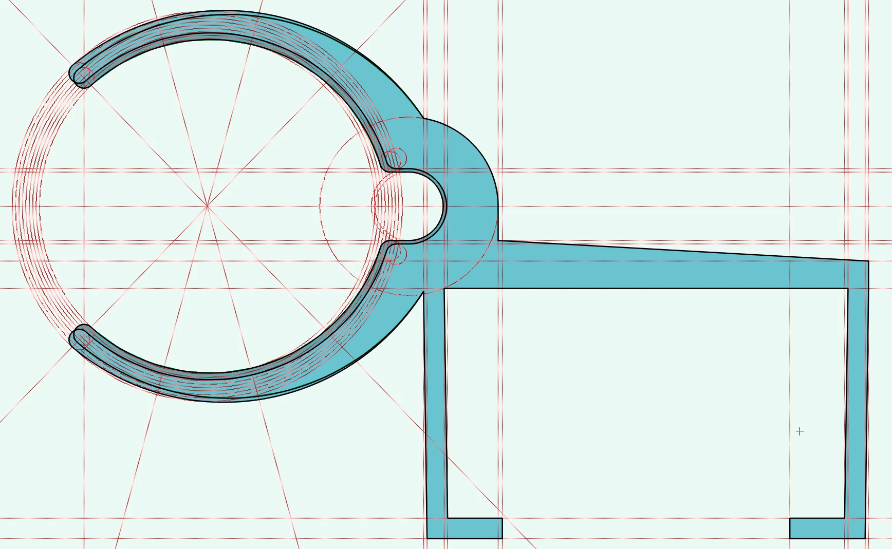

Hi community people,
I am VERY unfamiliar with 3D drawing tools, so please bear with me...
I am trying to create an object, which "almost" is a 2-D drawing, which must be pulled 30mm.
But the Top/Bottom surfaces are a little bit different.
I have tried to define 2 surfaces "Top"/"Bottom", but I do not know how to combine these and add the missing surfaces.
I have tried to use "Gather Faces" without success
Am I doing it totally wrong?
Best regards
Martin
PS: I am using "CREO Elements Direct".

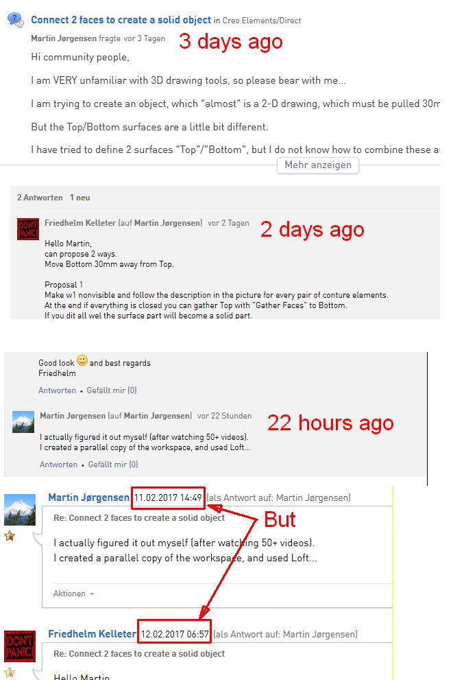

Feb 14, 2017 11:17 AM UTC
How did you do that with the date?
>I actually figured it out myself (after watching 50+ videos).
Great, congratulation

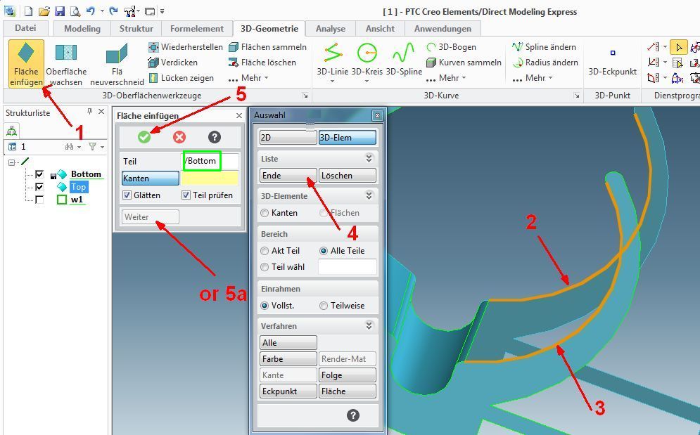

can propose 2 ways.
Move Bottom 30mm away from Top.
Proposal 1
Make w1 nonvisible and follow the description in the picture for every pair of conture elements.
At the end if everything is closed you can gather Top with "Gather Faces" to Bottom.
If you dit all wel the surface part will become a solid part.
But this all is a lot of work.

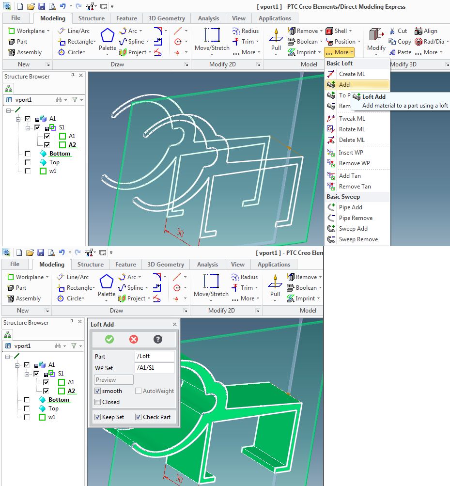

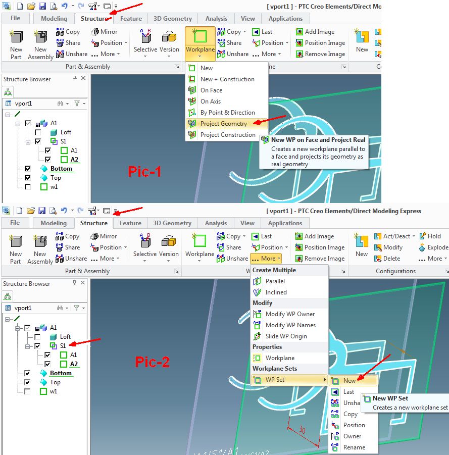

Proposal 2
Pic-1 create new workplanes on Top and Bottom and project real geometry.
Pic-2 create a workplaneset S1 and move the workplanes what you have just created into it.
Make Top and Bottom invisible = uncheck in Structure Browser..

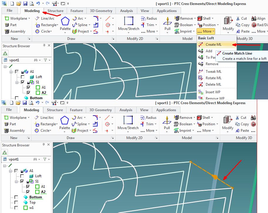

Now create a Match Line. You need only one but dont foget to terminate correctly.
Now you can create a loft. See picture.
