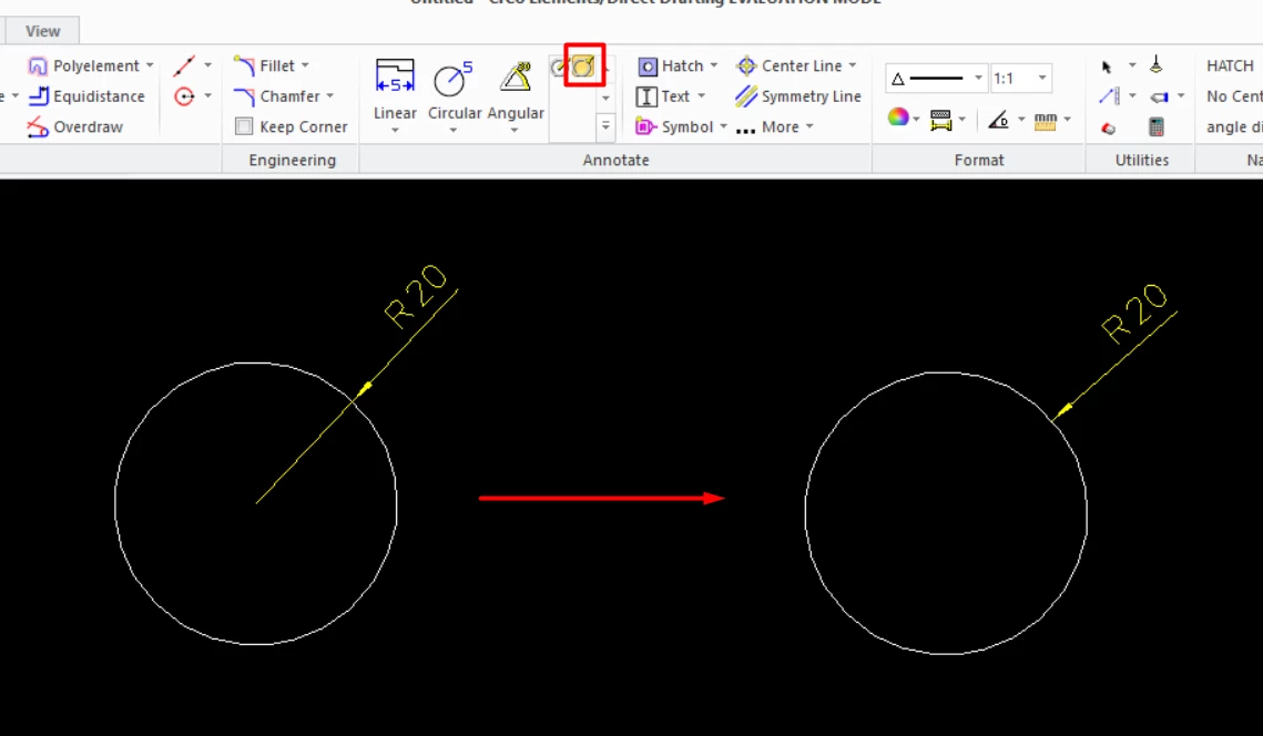

[Creo Elements Direct Drafting 20.7] Set NO_CENTER_LINE is default when dim
Option CENTER_LINE is default when I dim circular in CED Drafting 20.7. Please guide me how to set up option NO_CENTER_LINE is default.
Kotom-EngAnswer
Jul 29, 2024 7:56 AM UTC
NO_CENTER_LINE is an option of the command DA_DIM_DIAMETER. Therefore, it is not possible to set it up as default.
On way is to add a button with the action:
     DA_DIM_DIAMETER Assistance Placement NO_CENTER_LINE
