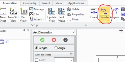

     I would like to know how a radial arc length dimension can be shown in a drawing view in creo elements also would like to know how circles or any isolated lines can be made hidden or removed from a main body surface in a drawing.

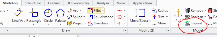

If I understand well, you want to attach arc dimensions to points that do not exist. Then I propose to cut the part in two which will create edges in the circles. I you do not want to have several "virtual" parts instead of one "real" part, you can use the "imprit" command.

Radial arc dimension: click on the button "Circular"
Hide a line or circle or arc: click on "Hide" button

    Thank you very much for your valuable effort for letting me know about hide button option. But still when speak about my arc length query, I would expect to get more information about how the whole process of adding an arc length in a given drawing view is done. Somebody please explains this step by step with some drawing examples.

Click on "Circular"
Click on "Arc"
Adjust dimension parameters if necessary
Fly over the first point of the arc. The arc and the first point are highlighted
Click where the mouse pointer is (not necessary to click right on the first point). You get an elastic between the first point and the mouse pointer.
Fly over the second point of the arc. The arc and the second point are highlighted
Move the mouse pointer where you want to put the dimension
Finally, click on that position
During the process, you are guided with the status bar
