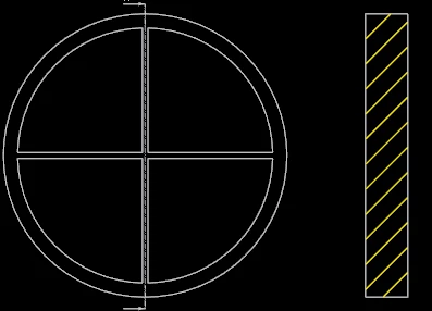

Hi
When I create a section view in the drawing the hatch will create for regions that are not necessary and these regions are part of cut exclusions in standards. What should I do to prevent cut exclusions in drawing when I create a 2D draft and section view and prevent hatches on these regions?

To hide hatching, I suggest to change the hatch distance to a value bigger than the width of the hatch zone.

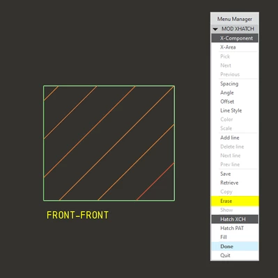

You can remove hatch following these steps:
- select Layout tab
- double click on hatch to open menu on picture below
- click on erase to remove hatch

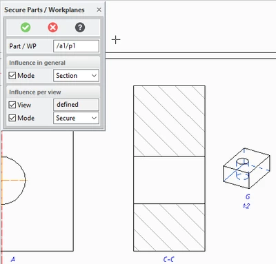

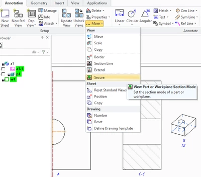

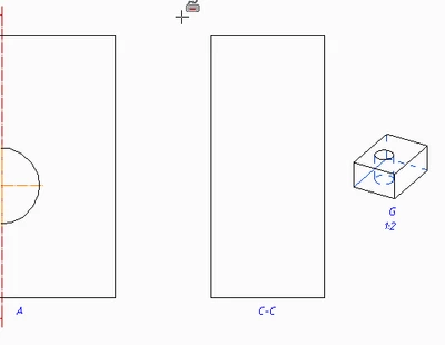

Try Secure as well:
Then update the view:
