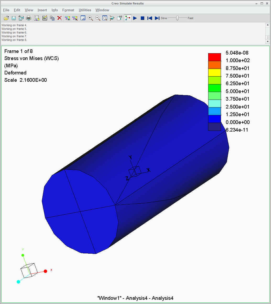

Hi Guys!
Nice one:
I've been running your example several times, there is one typical oops in your reasoning:
You've prescribed a tengential displacement of 10 mm to an entire face, that is not friendly....
The inner diameter would have to rotate more than the outer diameter. Hence the stress.
A prescibed angle in radians should solve this
However, this is not the only issue.
I've made some neat constraints, on the edges in stead of the surface. I see nice rotation (in linear analysis, with a scale factor applied this looks like the shaft is blowing up, but this is due to the scale factor).
It's still not perfect, I do get some stresses (picture 1)
You do have no stiffness, which should make this a singular analysis somewhere. This may cause the effect.
Just thinking out loud: What are the units (dimensions) of theta displacement? Is it angular, or (pseudo-)linear?
Have you used Total Load At Point? If so, try not using it... if not, try using it!

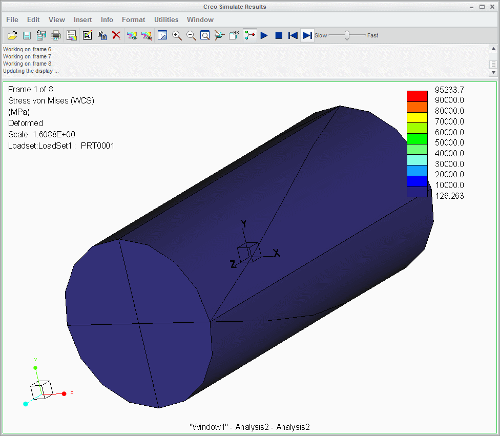

Hi Guys!
Nice one:

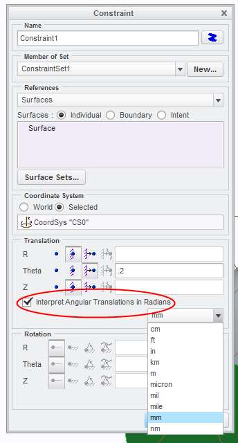

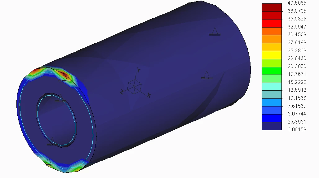

346gnu13-AquamarineAuthor
Erik, that's great.
I just tried it with the 'interpret angular translations as radians' check box in the constraint dialogue is CHECKED and put in 0.2 radians. (not sure why I didn't try that yesterday)
I misinterpretted the check box and drop down.
In my mind, a translation in theta must be an angle. I assumed the linear dimension dropdown was wrong (clearly it isn't)
I then further concluded that the check box enables the user to decide whether values should be degrees or radians.
So folks, it's moving all points of the surface 10mm in the theta direction (which must be undefined at the centre) unless you use the check box. pic and movie attached.
