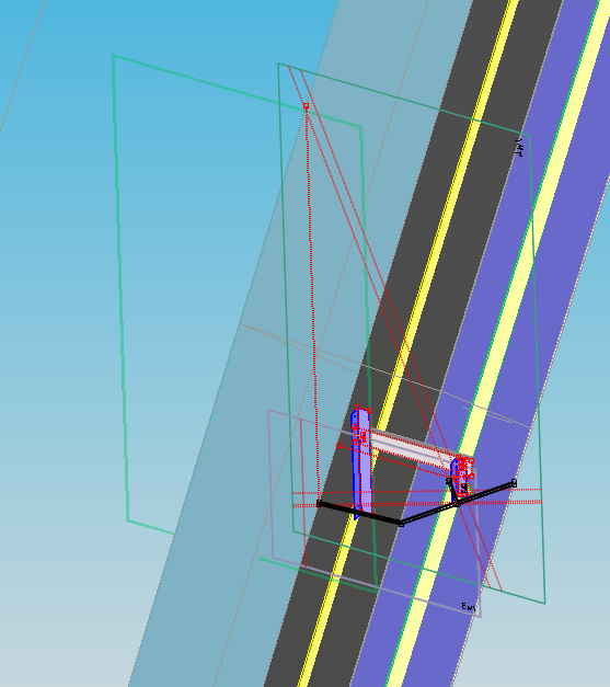

I am having trouble with the display of Workplanes in my Creo/Elements Direct Modeling. It is as if a shadow or copy of the workplane is displayed along with it - the shadow can not be selected and is not a separate plane. I have tried changing all visibility-related settings in the 3D Object area, Viewport settings, Workplane Properties and Show settings as well. I can not get the duplicate to go away and it is very deceiving when modeling - especially since I normally work with many planes at the same time. The number of planes I am seeing is actually DOUBLE what I should be seeing. Does anyone know how to turn OFF this option, assuming that it IS optional?

Hello, can you send some image to show us?

i have the same issue, should you have found a solution for this issue?
February 4, 2014
No - no one ever replied to me or addressed the issue, but it drives me crazy. It is very difficult because I work with models that have over 50 workplanes in them, which means I see 100 of them. Very frustrating.
February 4, 2014
Looks like a video card issue.
What video card are you using?
Have you tried to update the video card drivers?
February 4, 2014
I am using an NVIDIA Quadro FX 4800 card. I have tried updating the drivers and even had a new card installed recently. The card does have program-specific settings but I can't seem to find one that applies.
February 4, 2014
you do not happen to have a environment variable installed called SDPIXELFORMAT with value SOFTWARE?
i can simulate the problem when i set this variable.
are you using the certified driver or the most recent driver. the most recent driver is not necessarily the best!
