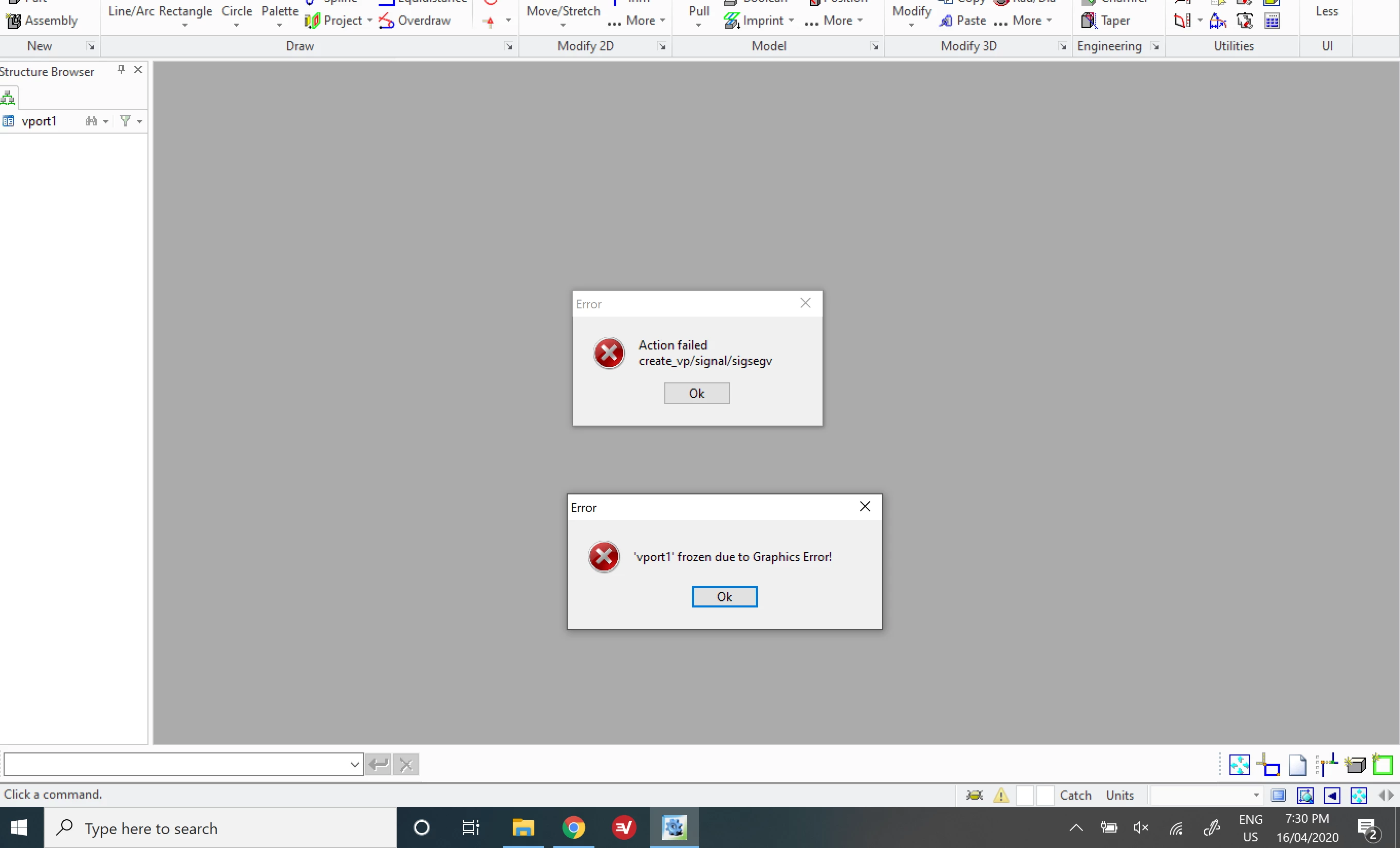

Error on startup of Creo
I have recently installed Creo Elements / Direct Modelling Express and have a couple of errors on startup (refer attached). Can someone please shed some light on the issues. Thanks in advance!

It looks like your personal settings were corrupted.  Whenever you close Creo Elements/Direct Modeling, it writes to your personal settings.
Sort the files by date.  Look at the latest files.  At the bottom of the file, you should see END OF FILE. If it is not there, that means the file was not written correctly and should be deleted.
