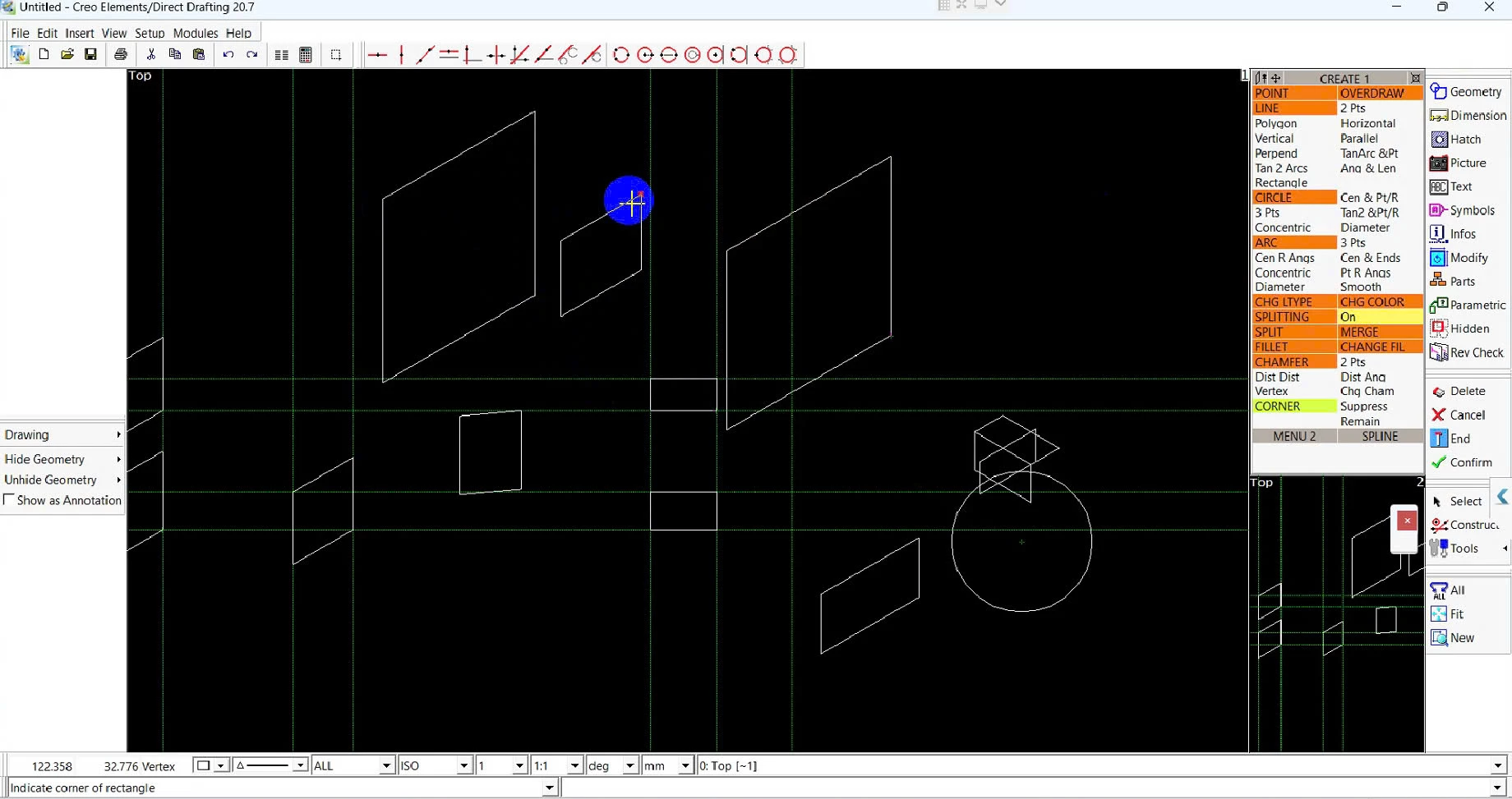

You are probably in isometric mode. To return standard mode type
CS_AXIS ABSOLUTE 0 1 90 1
Oct 7, 2024 2:34 PM UTC
Do you mean that you get a diamond instead of a rectangle?
Could you please describe a little bit more the error?
