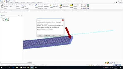

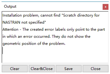

I met the problem showed as below pictures. Can anyone help me to slove it?

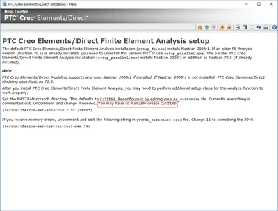

I have found the solution from Help Center.
