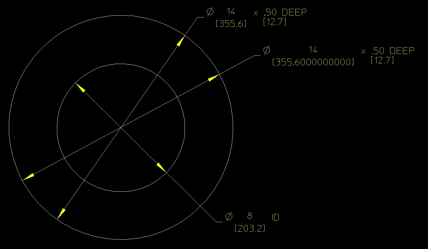

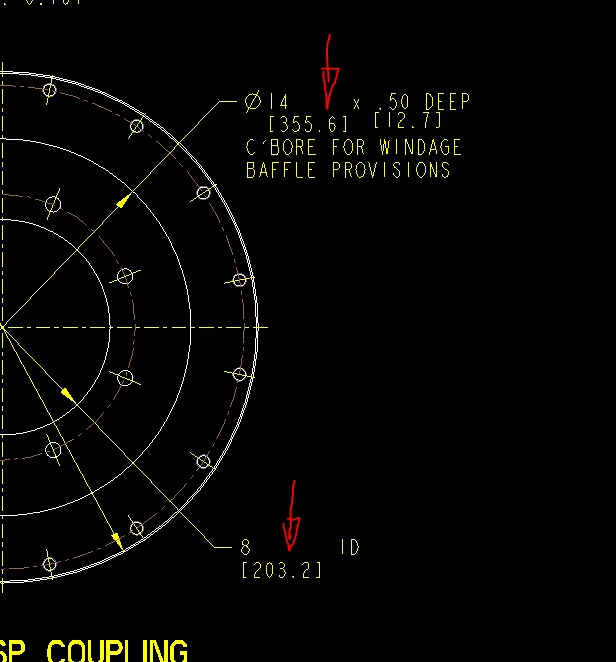

Is there a way to remove the gap, the space between dimension value and text you manually typed in a dimension?  we have our dimensions setup as dual with the metric values in brackets.
i would like my dimension to look like this:    14 X .50 DEEP,    not this   .....14                      x .50 DEEP
                                                                       [355.6]                                      [355.6]

Regrettably, there is no way I know of to do what you want. The dual dimensioning is convenient, but these kinds of odd behaviors make it kind of a pain. And the added page "real estate" needed to show all those bulky dims is not so great, either.

I think it is not possible as the 2nd line of the postfix would overlap on the secondary dimension.
I tried to get the same layout of the dimension as yours, but could not: the text is centered. However, if center is better for you than left justified, I give you my style file, maybe you will see the difference. If you find something, I would be happy if you tell.
