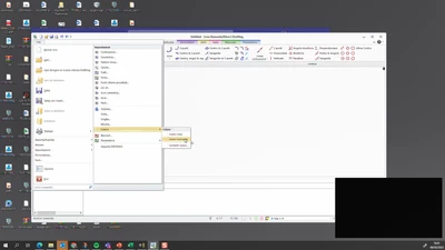

Mar 7, 2023 2:55 PM UTC
If you click on
you will get this look
Is this the look that you want?

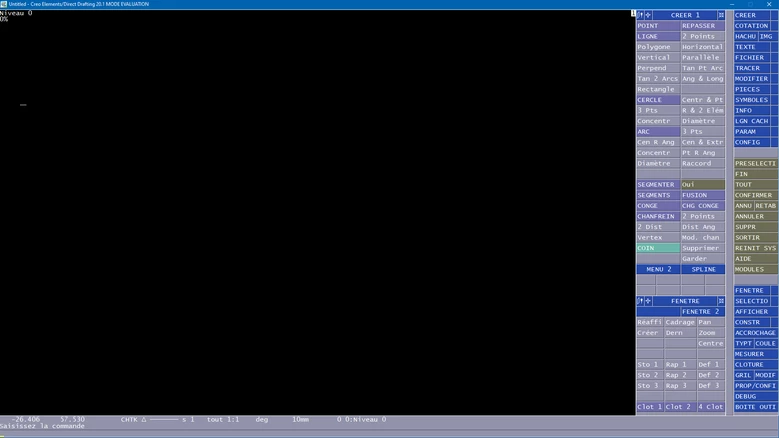

What I'm looking for the black screen (Cocreate colours).
Unfortunately, I can change the colors to the cocreate style after the start up, but I have to do everytime and the selection is not persistent.

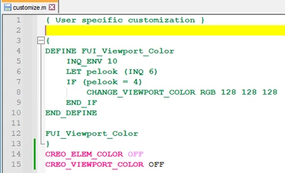

Mar 8, 2023 4:46 PM UTC
Add
CREO_ELEM_COLOR OFF
CREO_VIEWPORT_COLOR OFF
in the file "customize.m" of the directory "C:\Program Files\PTC\Creo Elements\Direct Drafting 20.xxx" and restart Drafting.
