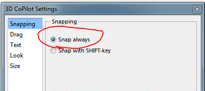

The other option is to change the 3D CoPilot settings so that when the cursor does go over a face it will snap to that face.
File->Settings->3D CoPilot Settings.

Thank you both, Peter Kehoe and Tom Kirkman.  Each of your answers completely solves the problem.   Excellent.
