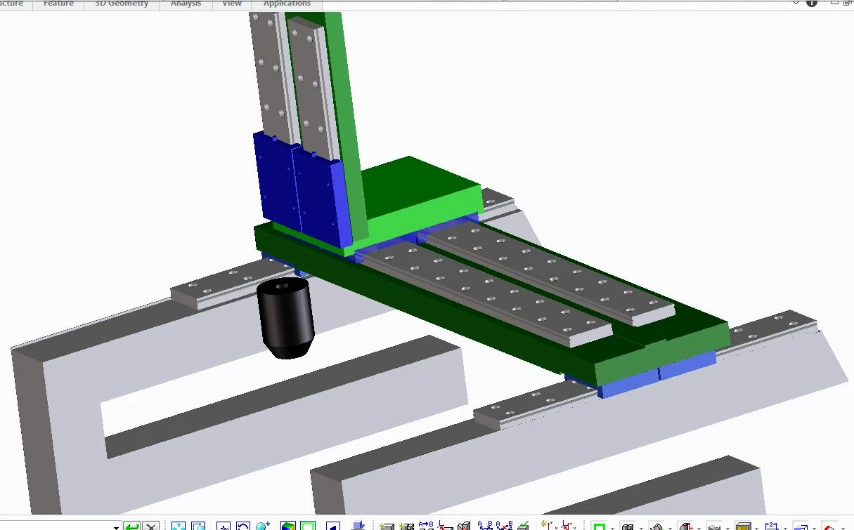

I have two bearing rails on either side of a drill chuck.
Ordinarily, in my previous program, I would construct a line between the two outer parts, then move the inner part by selecting on it's center, and moving to the midpoint of the line I constructed, with a filter allowing it to only move in the plane I choose.
But with Creo, I cannot even snap on a part that isn't active. So in order to even draw the line between the two outer parts, I have to activate one, put a workplane on it, draw a point in the corner; go over to the other outer part, activate it, then draw a line between the active part, and the point I drew. Then I can snap to that midpoint, and move my part. Is this really how it's done, or is there some easier way?
Also, is there a way to snap to parts that aren't activated? Some commands do, some don't. And it seems the commands where I need it, it isn't there, and vice versa.

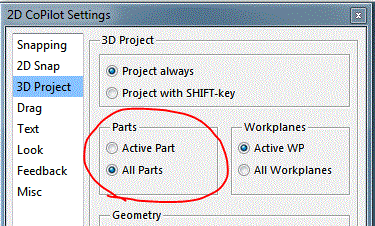

I think that you may want to change one of the settings so that you can snap to all parts. If you are using version 19, go to File->Settings->2D CoPilot Settings. In that dialog, select "3D Project". Then in the "Parts" section, check "All Parts".2D_CoPilot_3D_project.GIF

What a help. Thanks for your reply. I wasn't looking in 2D. Now I see why it belongs there.
I also found that infinite construction bisector works well for centering. I'm still getting used to the program. There are some pretty amazing abilities by just dragging alone. Lots of mysteries still.
