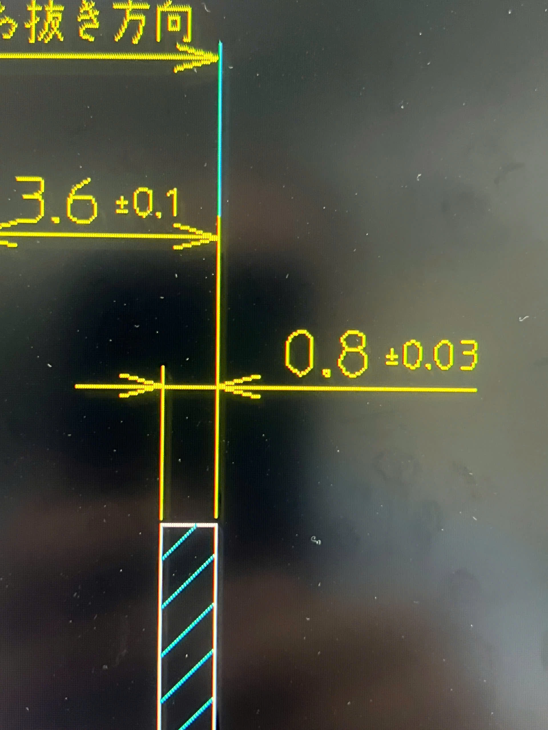

I have a issue with creating the tolerance.
For example. When I type the tolerance 0.027, it only show 0.03
I tried to find the Tolerance setting box and never see it. Please help me to  change this format. Thank you
